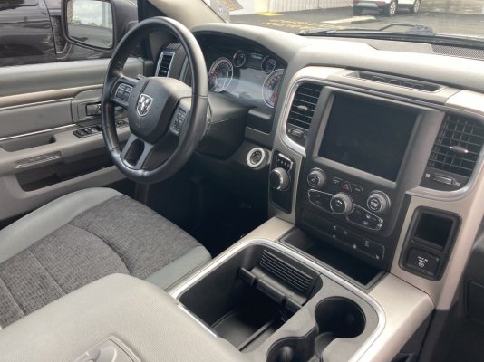

my 2017 has a power port in the rear of the console near the bottom for the backseat, if your son sits in the back.
if he sits up front put a usb charger in the port inside the console, under that cellphone holder thingy (sorry, dont know the correct name)

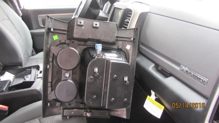

Under the console phone holder, there should be a cigarette lighter
You can remove the lighter itself & insert
Or remove the top of the console, 3 screws under the rubber pads
marked with blue tape
blue plastic piece is the cigarette lighter, it comes out fairly easily

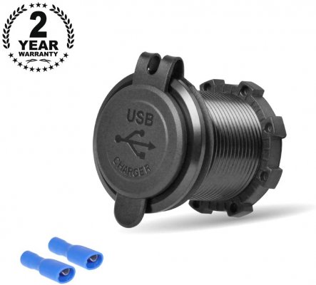

replace it with one of these
12V/24V USB Outlet QC 3.0 Dual Charger Socket with Touch Switch DIY Kit for Car, Golf Cart, Boat, RV, Motorcycle, Truck and More​
