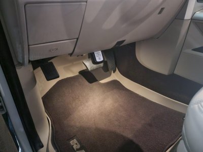

I got the 4G upgrade it works fine but I now have the ugly black box with a white label sticking out below my dash. see photo
Get a remote obd2 port. Amazon has tons of them. Gives youa port you can tuck up under the dash with your device plugged in, and leaves the oem spot open for diagnostic or other use
