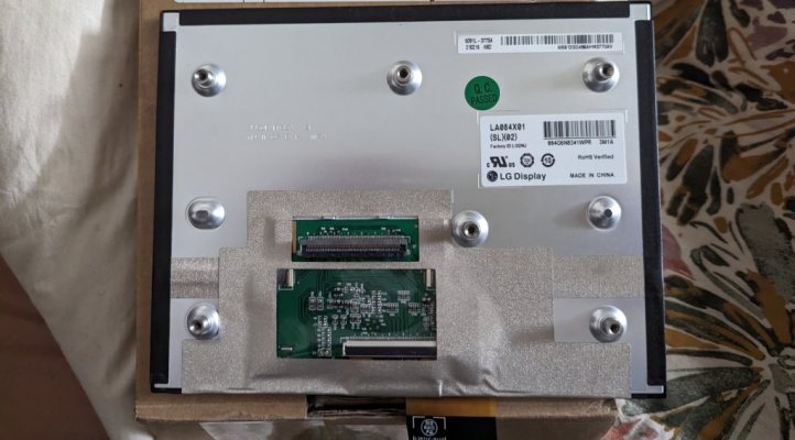

My Ram doesn't have a touchscreen as it's a 3rd Gen but my 2018 Challenger does. It has a 8.4" screen which delaminated and I just replaced the screen myself a month ago. Dodge cares told me I need to take it to the dealer for a diagnostics first which costs $100 and then they could help out....which who knows how much they can help out.
I went to eBay and bought a upgraded SL-02 screen for $225. I read it's not supposed to delaminate and it was real easy to install and it works great.
Loads up way faster than my stock SL-01 and just performs better and is very clear now as whatever coating is on the stock glass left permanent dull finger marks on it where I use the icons the most.
Hopefully the newer version doesn't have the same coating on it as it seems to look more glossy.
When I mention SL-02 it is marked in the pic on the LG sticker under the model number.
Stock is a SL-01 for my year anyways and they all delaminate. There is also a SL-03 which is more expensive and a lot harder to find.
Not sure what is different about that one but my 2018 allegedly can use that one as well.

eBay...and search for your year and 8.4 replacemnt uconnect screen and it will bring up many of them to choose from. They range from $205 on up to over $300. On Amazon they were much higher.
The people i got mine from has since raised their price to $300 and why i suggest you search, but...if you want the seller name is Top-Autopart.

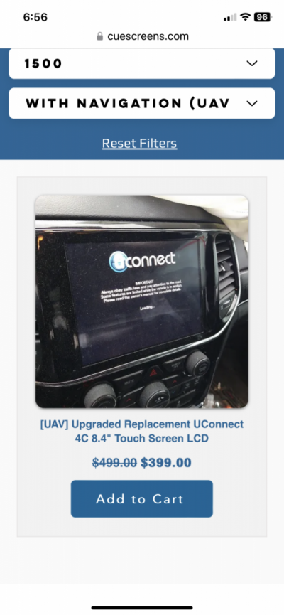

Has anyone installed a replacement screen from Cue Screens? Mine is delaminating and I am thinking about buying one.
Do you have a link?
If you want to spend that much but i got mine $170 cheaper on eBay as mentioned above.
Ollie2023
Feb 14, 2023
Texas
$170 does sound better, I guess even if it is lower quality I could get more than 2 of them for the same price. I bet it’s the same screen anyway. I’ll look into the eBay screens
Its $170 cheaper. It isnt lower quality, they are the same OEM screens made by LG.
The cost was $225 plus tax. And its the same screen as far as what it does but its a SL2 which is version 2 from the original that everyone is having issues with. SL2 isnt supposed to delaminate. There is a SL3 but it is around $400 and harder to find.
Look at the pics and they will have stickers on the back and look for the SL2 because SL1 is still out there and they will be even cheaper but you dont want the same issue.

Interestingly the picture of the 8.4 screen on Cuescreens website shows an SL01. The description says all new design, upgraded components, etc.
