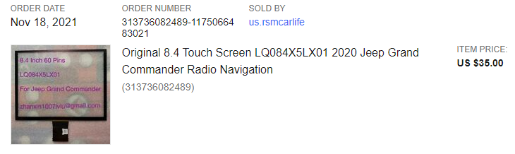

This thread is a little old but I thought I'd add that it is possible to change out the digitizer yourself and save a few bucks, I did it for my 2018 Big Horn. It's been over a year since I bought the digitizer on eBay and when I clicked on the listing the price has went up significantly. Anyway, it's fairly easy to remove the old digitizer, just make sure you have plenty of rubbing alcohol and wipes to clean the mess the old one leaves on the screen. There's also some YouTube videos that will give you an idea what is involved. It's been working fine since the swap other than the normal uConnect glitches.
