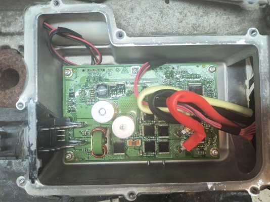

Pull the cover off the module, uses a security torx. Check to see if there's any corrosion on any of the contacts and try cleaning.

Went ahead and pulled the rack (it was very easy). Popped the cover of the module and everything looks neat and tidy, no signs of moisture or something getting cooked. A week ago I loved this truck. My how things change.

Did you visually inspect the wiring and connectors, then if good, check for power at the EPS connector?
I recall a recent thread about a truck with similar symptoms, where the guy felt something under his back while inspecting his EPS wiring. He found the offending object to be a piece of his EPS wiring that had been chewed off by a squirrel.
Or something like that.
