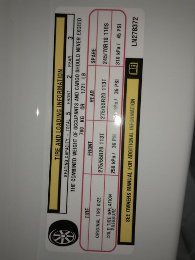

I would be very surprised if your payload was 1700lbs. The only 1500's I have seen with that high of a payload was a stripped down Tradesman. Check your yellow door sticker
Surprise!

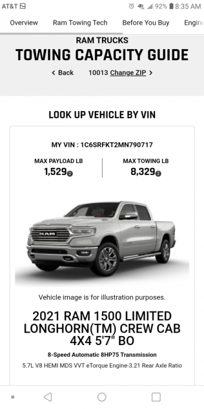

The only option my tradesman Has is tow mirrors. I have a 2998 Payload. The chart says 3110. So...they didn't include 33% of options.
I give in. I am over the towing discussions. 28 more days to camping. I know what my truck can tow and haul...and my camper is a perfect fit.Screenshot_20220311-095214.pngScreenshot_20200526-084249~2.png20200829_103707.jpg20201031_151201_HDR.jpgScreenshot_20210221-170506.png
GVWR 10000
GCWR 19400
10000 minus 2998 equals 7002
19400 minus 7002 equals 12398
Front GAWR 5500
Rear GAWR 6500
I have plenty of capacity left. I let that HEMI sing it's Anthem and enjoy every trip.

Let me rephrase this...
It is 40mph the combination must maintain up hill. So it is worse than I said. I understand now...how i wrote it was confusing.
GCWR is what is set by SAE J2807. (Which is with 300lbs for passenger and driver and 70 to 150 for hitch depending)
When you use the ram site to get your VIN towing number it is just GCWR minus Base Weight ( or curb weight for those that argue that)
So no driver or hitch figured in. You need both.
For example...to try to not have confusion
7100 GVWR
13900 GCWR
7100 minus 1529 equals 5571
13900 minus 5571 equals 8329
No hitch. No driver.
Thanks for following along. I'm out
