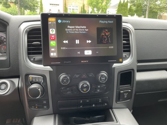

I’m having a Sony XAV9500ES installed this Friday along with the appropriate Maestro RR and harnesses. I’ll post up some pics when it’s done. Also considered the Kenwood excelon DMX1057XR.
The Sony is on sale for a great price right now.

After a couple weeks of ongoing issues I returned it back to stock. Honestly not worth the headaches. It’s a beautiful big screen though.
The first unit was DOA and once the warranty replacement came in, the Maestro RR started acting up and I lost all stock functionality.
I’m sure others have had good experiences, just not me.
