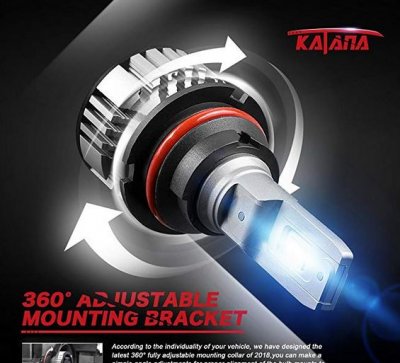

Do you have any pictures of the bulb and output?
My only concern is from what I have seen/read, the LEDs with the flat end on them like these do not work particularly well in projectors. The LEDs that are shaped like the Katana LED (flat through the end) work better in projectors from my understanding. Pics attached for reference.
VLED Extreme
Katana LED
I have the Katana currently, and aside from the 6500k blue color, they are great. I think a similar light at a 5000k would project much better and offer better lighting in the distance, I'm just concerned about the design in a projector. I could be completely wrong though.
