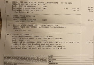

I had an issue with my 2014 1500
It felt like the electric steering rack was seizing up when I turned left
At first it was only sporadic and kept getting worse. A local dealer suggested I likely needed a new rack which I wasn’t too happy about
As I investigated the option of doing the work myself I accidentally discovered the problem wasn’t the steering rack but the universal joint in the steering Shaft was the problem
I cleaned it up and lubricated it and suddenly my problems were solved
I can’t say what might have happened if I had dropped it off but I am happy I didn’t
haven’t had an issue since

"I also had them service the truck as it was due anyway...including the service AND the steering rack, we're looking at $2400 plus tax"
"So, we are going to have to put on the OEM rack which will cost $1825 instead of the $1625 for the aftermarket."
These two quotes are from the original OP post.
As I said before, an aftermarket rack is $1197.
Obviously someone here is not able to discern the difference between parts cost and TOTAL cost.
Or the obvious markup (hosing) by the dealer on said parts.
I'm done trying to impart the benefits of comprehension.

So, yes, the aftermarket rack they quoted me was $1625. The OEM was $1875. See attached image of statement.
