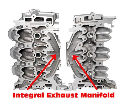

I also read in your offered website on engines that this engine has its exhaust manifolds cast integrally into the heads. Some time ago, I asked around on one of these forums which was about warped manifolds, broken exhaust bolts, etc. on the hemi's if that was also a problem on the V6. I was told that yes it was, watch out. So now I'm not so sure about that. But it could still be a problem where the exhaust pipe connects to the head, right?
Possibly, but I really haven't seen too many folks complaining about the exhaust on the higher-mileage v6 3.6L motors (and good luck getting headers for the later v6 Pentastar engines, because yes, the manifold is integrated, IIRC.)
Yes the manifolds are integral and cast with the heads. Have yet to see anyone say the exhaust pipe bolts have cracked on the V6, and there's only 4 on each side.
View attachment 201390 View attachment 201391
Wow, nice pictures, thanks. The more I learn about this engine, the more I think I lucked out buying this one. Saving pics to my favs, yes.
So next question: Can you share where these pics came from and is the rest of the engine shown like these do?
I also find from rolling under my beastie that the exhaust piping is large for such a small motor---compared to what I'm used to seeing on older cars, even with V8's. So I don't see a big advantage to installing aftermarket headers on this guy---some, no doubt---but not heaps of gain, I think.
So from past experience with Dodge Slant 6's, which had a tendency to loosen up the exhaust manifold after many miles, part of the trick is to have good support for the exhaust pipe going down under the engine to keep the weight off of the manifold. I have no problem with adding a pipe support bracket if it looks too heavy for the manifold connection. With only 4 bolts holding it up, I think I will take a hard look at that---shouldn't have any effect on my warranty I believe. Preventive maintenance is my game.
Found the pics on a Jeep Cherokee forum thread from 2016. Not much else there about the engine. They were discussing putting new headers on the Pent V6, which of course is impossible. I don't think I'd add any supports to the exhaust pipe. I suspect the engineers put what they deemed appropriate. May even cause harm IMHO if you stiffen it, when it may need to allow some movement as the engine moves.
