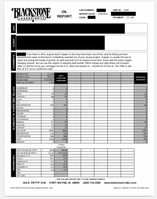

Wow, perfect timing! Just got an email back from Blackstone, redacted some personal info but here it is. Now I have some research to do to dig into all these numbers lol. Based on this report, guess I'm just going to "make like an ostrich" and pretend I don't hear the noise then.
is this redline and first time using redline?
So it is a young engine, looks fairly average for hemi with young engine and 12k miles on oil. However, if that is 5w30 redline, it does appear there is some mechanical shear with that viscosity. 7 quarts 5w30 redline? no additives? no mixing?
Yes, that was first oil change using redline 5w-30. I didn't change the oil myself so I don't know how much (quarts) they added. It wasn't above "full" on the dipstick. I did not mix anything or use any additives or touch the oil in any way other than the oil guys pouring in the oil during the oil change. I used the royal purple oil filter recommended on this forum as well.
(also, it's 12000 kms on the oil, not miles, not sure if that was a typo or if that changes the situation any)
How do you determine mechanical shear? Are you saying that because of the high amount of copper or is there some other value on the report that points in you that direction? (Just trying to learn)
So first, every uoa on redline is high wear ON THE FIRST RUN, there are at least two possible reasons and theories, one is heavy aw additives that actually create wear and lower wear (it knocks off any sharp edges to new metal), the other is that esters leach metal ions out of metal, we do not know for sure to the why, but I'd expect the next uoa to go way down, so I hope you do another uoa and post it in blackstone thread and let me know when you do. Both theories allow for why the wear numbers tend to go down long term.
Second, it is rare to see 5w30 redline anywhere under 12cSt, you are at 11.27. I can't say for sure, but another theory is the engine is shearing the vii's in the oil. Again, a second uoa will verify what is going on there. It doesn't mean anything at this point, shearing oil is a normal thing, it is just a little rare to see in redline 5w30, but not unheard of. Surely it isn't the end of the world or anything to worry about. I can't wait to see your next uoa, I hope you take blackstones advice and run it for a long interval. pm me if you can remember when you get your next uoa, thanks Burla.

Awesome, appreciate the feedback. I will definitely do another Blackstone and post results, I've been worried about the various engine noises these hemi's put out so my hope is that a constant oil analysis might alert me to problems before they become large and costly; so I would just trade it off at the dealer if the reports start to worry me.

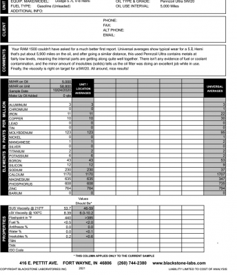

Here's the first analysis I had on my 2011 with 58k miles. I have mostly used Penzoil ultra throughout the past 4-5 years but recently started using lube guard also. The only noise I have in what sounds like either piston slap or a lifter leaking down.
I hear a ticking pinging noise at start up that goes away within 15 seconds of driving when cold. After that throuout the day it never comes back until the engine sits overnight again.
I t seems to be coming from the front below the head
I do have shorty headers on it.
I bought the truck new and I kinda thought I always had it but can't be sure.
Anyways this is what mine looks like to compare
