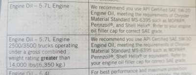

Would the 5w-30 void the warranty? Mfg calls for 5w-20.

Read the note at the bottom,this is from the 700 page printed manual for my 14,that you won't have.
The only thing my '15 manual has is this:
It is the same 5.7L engine in the 1500/2500/3500, so what gives?
I may try 5w-30 next change just for ***** and giggles.

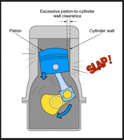

Anyone have any good videos which demonstrate piston slap sound?
So far I think I've identified exhaust leaks, lifter tick, injection tick, and engine ping, but have yet to hear what piston slap sounds like. I believe I am hearing this in my truck and I've been running redline for over a year with two oil changes now, but still no improvement on that cold start knocking sound.

If it only happens when cold, it is piston slap, sounds like a knock. Which redline are you on, and what temps have you heard this slapping? Did you have hemi tick prior to this piston slap? There is nothing you can do except run a thinner oil, we found that is most cases this does help a bit, but when it is cold the metal shrinks, so sadly it can get worse as tolerances widen. Maybe get an engine block heater, or oil sump heater as a second play.
That's from the 700 page printed manual that you had to phone FCA to get Ed.From what i've gathered up you guys south of the border can't get that manual anymore,but it's still available for us Canucks,as i ordered it for my wifes 2019 Challenger 1320 and got it about a week after ordering it.It's a thick printed manual similiar to what you used to get years and years ago when you bought a new vehicle,before manufacture's went cheap,lol

You have a big metal block and a small piston, metal shrinks in the cold, the only way to stop it is prevent the metal from getting cold, IE garage or heat blanket, engine block heater, sump magnet heater blanket. See if calling @Hemi395 works, the guy has led the way on a lot of testing these hemi's, and this issue for sure. Corey can you add anything to the convo?
