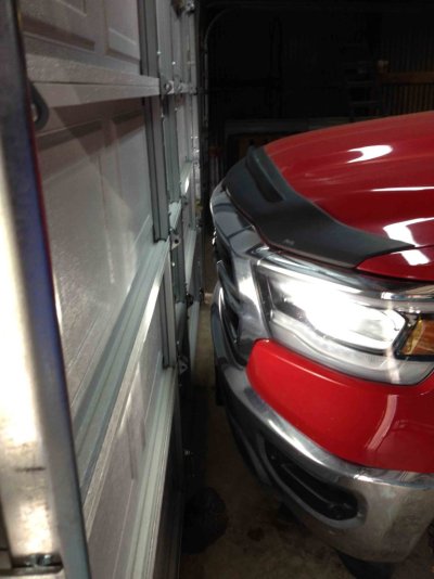

Mine is OK, but I learned. I was at a restaurant with a MC Club backing near the restaurant, and the system picked up some leaves on a branch and slammed the brakes. BOY, did I get some weird looks. If I know I will be backing in a lot of tight spaces, and I am concerned, I may turn on, but TBH, I leave that PITA system off. But usually, I just leave the sensors on low and keep the rear assist turned off. When I put truck in garage due to bad hail coming, I have only a few inches front and rear, and not need that system locking up the truck. I need no nanny system to tell me how to back up and when to stop. The rear camera system is nice also, and helps.
