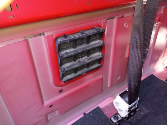

I need to replace the two vents in the rear cabin wall. I see a bunch of YouTube comments on this, but I want to make sure I order the correct part number.
Can someone advise?
Thanks.

Part Number 68323649AB
Good thread here on the revised part...

Did mine in about 90 minutes. Hardest part was pulling out the seats. The new OEM vents are about $25 for the pair
TIP: Tie a string to the old ones before removing so they don't vanish between cab and bed. Same for the new ones during install. Just need to "force a little bit" through the hole and at an angle (they flex pretty easy if warm)
