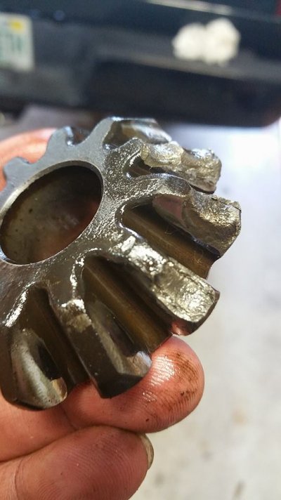

I opened the differential and one of the Spider gears had 4 chipped teeth. Pinion and carrier bearings all seem fine. No play.
Would that cause it?

Thats intresting.... How big of chips?

not limited slip. Just a 9.25. 12 bolt diff.
I just replaced the spider gears today and will fill with differential fluid tomorrow and do a test drive.
