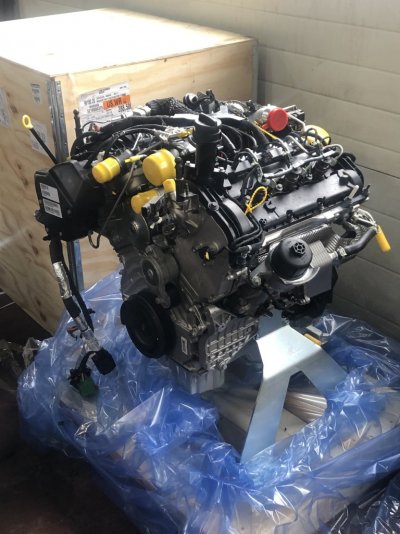

The 2018 RAM ECO diesel is a piece of crap. in shop more than on the road. Two motors now, gutless piece of junk. Heres the latest engine they are replacing..NewRamEngine.jpg
