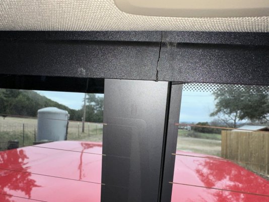

Yes, I see small hairline cracks on both sides though the rear passenger side is easier to see. Zoom in and you should see the crack. @mikeru 20240208_120803.jpg

They are replacing the tail light no charge so that is good. But they said the cracked window/frame is not covered so we didn't move forward on that just yet. @RamCares the crack around the frame should be covered per the TSB but my dealer wants to charge me for this. Please assist.

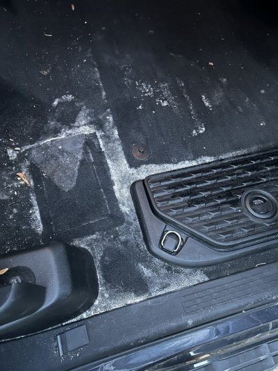

I have the same issues, headliner downs seem wet but floor actually has mold on it. I think the floor mat being hard rubber created more moisture and trapped it which amplified the mold. But window frame is clearly cracked on top and bottom. Already had headers replaced too, 2019 IMG_3165.jpeg

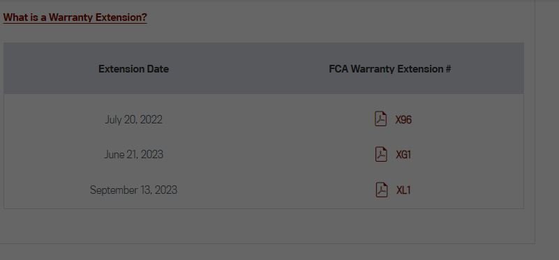

I figured I'd just make a new thread rather than try to update existing threads on this. For 2019, 2020, and some 2021 1500's (DT) Stellantis is extending the warranty on the 3rd brake light and rear windows that suffer from water intrusion. Here are the TSB's...
