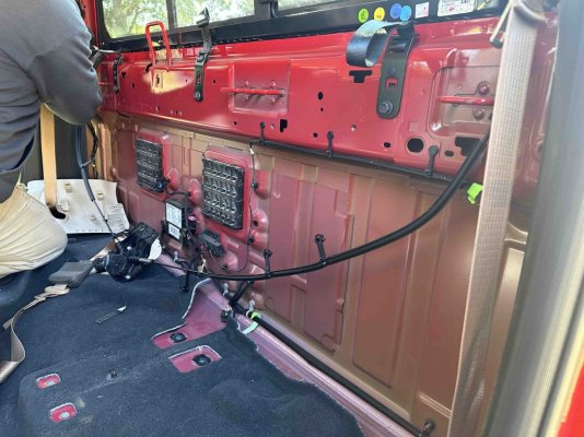

Well window glass company came today to my house and replaced my entire rear window with slider and all appropriate items. Man, he had to remove everything to include seats, even the rear wall carpet/insulation since the controls for the slider and the heated rear window glass stripe run thru a Relay mounted on the rear wall. But done and on RAM's dime.
INFO: Vehicle glass company, 3rd party, contracted by my RAM dealer to do all their glass work.

What the cracks in rear window slider backlit looks like: FTR seems most of the TSB refers to crack on one side mine was cracked on both sides upper interior slider frame.

Inside back wall RAM 1500 (5th Gen)

I'd see if there is a way to better protect the RF hub from water while you have it torn apart. It's definitely vulnerable sitting where it is between the cab vents and below the slider. Even though they replaced your rear window it could eventually leak as well. Lots of people have had the rear window replaced multiple times. One guy in another forum is on his 5th rear window.
MY rear window was actually in there pretty darn good. My issue was the cracked frame in 2 places and possible CHMSL issue which was also replaced. Yeah, maybe should have did something, but of course all put back together. The window tech said they HAD to save the rear window they took out and return due to "warranty" work, LOL. I looked at the rear vents and they looked ok.

The RF hub is right between the cab vents. Where are they getting these first year engineering students from????
WHO knows, just thought I would POST a pic of the entire area, may help someone out in the future. Wat a monkey goat f___k to get to the back wall.
