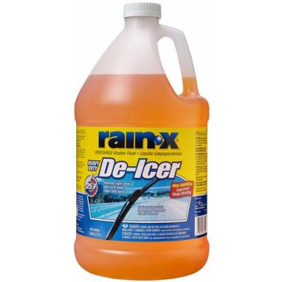

I have never had any problems using Rain X washer fluid, which one are you guys having problems with? I used the Rain-X pictured below from March of 2006 to Feb of 2021 in my 2006 along with my wife's 3 different Dodge Journey, 2010, 2014 & 2017 and none of them ever had problems using it in temps from 105 to -20 below zero...
It was that stuff i used in my 2011 town and country and I had issues with it along with others. However it seems there is a good bit of luck involved... some use it and never have an issue. I use it in my non chrysler products because my wife keeps buying it by mistake but... won't put it in my truck or her van.
We have used this Rain X in over a dozen different vehicles since 1995 from all 3 brands along with Nissan and Toyotas and not once had a problem from using it and know of many others who also use it without problems, I guess we are all just very lucky...
Do a search on here,you'll find quite a few posts about Rain-X Washer fluid gumming up the sensor and the nozzles.It's fairly common knowledge on here that Rain-X washer fluid causes issues,the de-icer version you're using might be okay,but the washer fluid versions don't have a great rep in Chryco products.They have a few varieties of fluids.
I now use either the all season Rain X or 2 in 1 washer fluid over the past 5 years without any problems, I have never tried the washer fluid additive in yellow bottle because I thought it was just to replenish the ability to bead/shed water and not for clean the windshield...
You should go buy a lottery ticket,as you're one of the lucky ones,lol. Lots of guys have had issues with Rain-X,plus it's not much better then the cheap stuff you get at the local gas station.The couple times i used it,i wasn't impressed,i find polishing the windows every time i polish the vehicle works just about as good.

Now that I'm getting old and stupid, sometimes I forget the past and buy some more Rain X when I see it in the store. I have had some Chrysler products that this has never happened too, but I do recall more than one of my Chevy trucks that this Rain X would gum up the pump/sensor.

I recall this rain-x issue from many years ago. If my memory is correct, the issue was with the orange-colored rain-x solvent and some, but not all manufacturer's fluid level sensors. It contained silicon which put a difficult-to-remove coating on the fluid level sensor causing false readings. I remember there was a class action lawsuit filed over this but I don't recall any ending.
For some reason, I have the impression someone, either Rain-x or the manufacturers did something to stop the issue but I could be wrong about that.
Again, this was an issue with the orange-colored rain-x. The type of rain-x fluid and the brand of the level sensor played into the issue and why some have/had and others didn't have issues with the washer fluid level readings.
