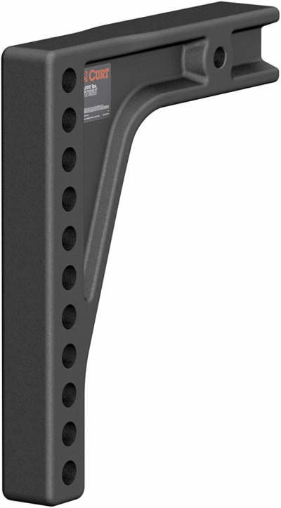

I replaced the 2 inch (Class IV) shank on my Curt Trutrack (17500) with a Curt 2.5inch 8 inch drop shank that works with my TruTrack.

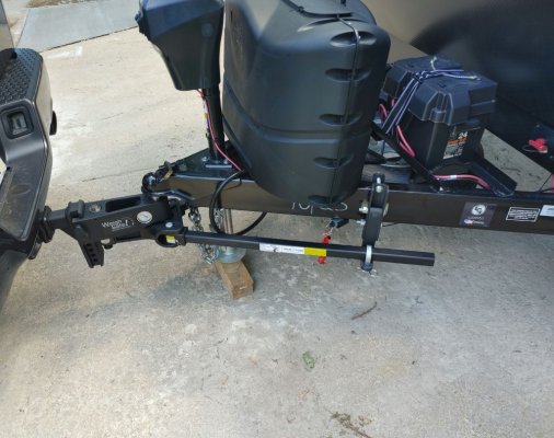

Weigh Safe True Tow has an extended 2.5" shank that comes in a 6" or 8" drop. You can lower your tailgate using that but it's rated for up to 2k tongue and 20k towing. It might be too heavy duty for your trailer. You'd have to call them to find out.
I'm using the 2" model with a 6" drop and it's rated for 1.5k tongue and 15k towing. It also comes in 8". I can drop the tailgate with it too. You could try this one and use a sleeve. 20210624_111019_HDR_1.jpg20210624_111504_HDR.jpg

When I upgraded from half ton to 3500 this past spring I had to get a new shank as well for my WDH for camper. I found out that all of the shanks are pretty much plug and play with all of the standard units unless they are a special kind of WDH. I ended up getting a curt 2.5 inch shank with a 8 inch drop and it fit my Reese system fine.
