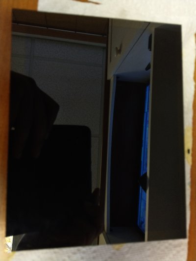

I just changed a screen on a 2019 UAS, every used radio I have bought (except one) had bad wear on them. They are fragile. Just for fun , I tried a few cleaners on the trashed screen. The coating comes off very easily and then it looks like a flounder’s skin. Spots, darker marks, etc. The $100 replacement screens work great. Getting ready to change another soon.
For UAS and UAQ radios:
LG screen part #LA084X01 (SL) (01)

If you go farther and remove the factory screen protector it shiny glass underneath...ba143d3ff371ebe8d845283a24496440.jpgafea24f7c3bdfa18054de55c83f8d184.jpg

Screen refinishing...
https://www.ramforum.com/index.php?posts/2185094
Screen replacement...
Replacement Screen Part number LA084X01-SL01 (or SL02). Salesman sample screens can be found for under $100 on Alibaba and I bought mine for around $170 on eBay.
The aforementioned screen replacements are for 2018 -2019 classic 8.4 inch screens only. They might work on a 2020 classic too but I haven't opened one of those to see.
