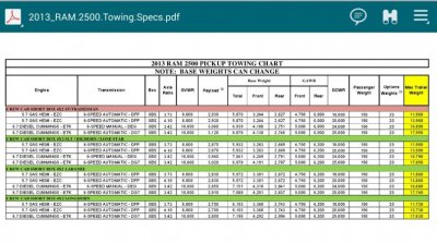

well, look at the 2012 vs 2013.. Same axles, drive train, frame etc.. A 20 hp more (same torque) with auto tranny and 50 ft lbs more torque with manual transmission, yet using 3.42 gears (all that is available on the 2013) you can almost tow 8000 lbs more with the 2013 vs 2012.. Using that, i pretty much don't agree with ram on any of their tow ratings, since there's no way going from 350 hp to 370 hp will increase your max towing from 9600 lbs to over 17,000...
[/attach]uploadfromtaptalk1415547332668.jpg
There is only a 2000 pound difference between the two. I don't know what the change was but the GVWR went up to 10000 pounds, that would explain the increased towing capacity.
14hemiexpress
Mar 30, 2014
3,654
1,200
Texas
6.4l
[/attach]View attachment 39194
I see the 2000lbs difference in the max towing but the 2012 got 4.10 with the 6.7. The 2013 only has the 3.42 and with the 3.42 on the 12 the max towing is only 10,000 and the 3.42 on the 13 is almost 18,000. It just has me curious

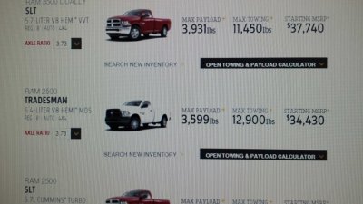

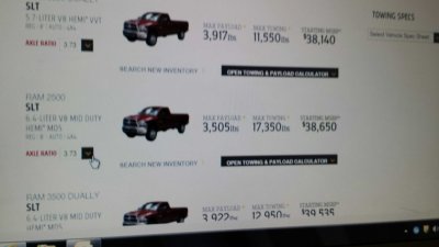

Still no explanations for difference in 14 vs 15 tow capacity though? It might just be a typo but im pretty sure ram uses the newest standards to rate towing which should mean they have the most legitimate ratings on the market
regularcab2500
Aug 21, 2014
1,321
341
Buffalo
1997
5.9 Magnum
I meant to post this instead of the bottom picture...
loveracing1988
Jul 4, 2013
3,508
918
Clarkston, MI
It is a typo. No 6.4 is rated to tow 17000 pounds. Also you cannot get 3.73 gears with the Cummins in the 2500.
