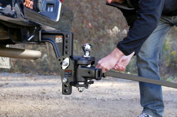

You may have issues finding a WDH that will work with a 7" lift. My son had a 2500 all stock and he had his Husky Centerline adjusted as low as it would go to get a good setup. It was initially set up from the RV dealer for my 2013 stock 1500 and we had to lower it one set of holes and had no more adjustment. Truck was 100% stock with stock tires

I missed the part where your truck was lifted 7". That's going to be rough to improve on as far as towing goes since "lifted" and "towing" are inversely related. I would definitely get a good WDH for a start.
I think 18crewdually might have found an option for that.
