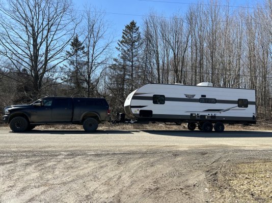

My PowerWagon has bags and an Equalizer WDH! Bags with cradles help with the lighter rear coils and let me keep articulation! WDH makes it a pleasure to tow!
WDH needs to be set up properly for your vehicle and camper/trailer!
E65B2025-75B3-4F68-9EA3-4B8ABE2F8896.jpegFD454928-14E3-4A37-B3D0-03D7CF039DC0.jpeg60BE210D-8C37-4956-9EA1-1D05C44020BE.jpeg95A29D19-07AB-4154-A906-3CC0523FB2A4.jpegAE8A5672-324C-4691-ADFF-C1253A5F0ADD.jpeg
I had to adjust for the second camper’s weight and height!
