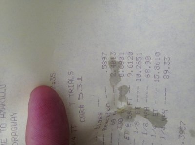

I Have A 13 Ram With 14"Mangaflow
VR CAI I Just Went Through The 1/4 Mile And Extramly Disapointed
15.8 I Was Faster Bone Stock Dont Understand And Extramly Disapointed

What was your stock time and speed? Maybe the temp / humidity / barometric pressure / etc / etc was different when you ran both days?

The only accurate way to do the comparison would be to literally swap those mods on at the track that day. Your track times will vary drastically from day to day, it's all in the weather my man. I will say a 2.4 60' is horrible, were you spinning? How was the 60' when you were stock?

No Not Spining At Runing A 15.6 Before Mods
Also 70 Degress Here So Not Bad And Not Sure Of Humidity
But Was Hoping For 15-2 15-3

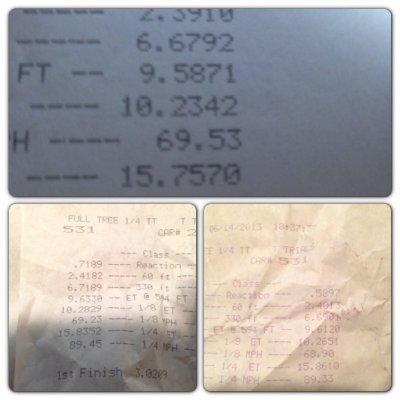

1/4 Times Extreamly Disapointed
Miserable After The 1/4 Mile
Best Time 15.750
Y-Pipe And 180 Degree Not Installed

Please don't take offense to this, but if you ran a 15.6 before and 15.86 now, do you just need more runs to build consistency?
Unless you're extremely dialed in you're likely not to notice a difference with the 180* Tstat and Y, but the VR should have made a slight dent in your times, all else being equal.

Weather and heat under the hood plays the biggest factor in 1/4 mile times with simple mods.
You can pick up half a second or more going from +1500 to -1500 DA

What track were you at and time? Can look up the DA and see what it is corrected.

You were running in 6079 DA so your running faster then that shows just the DA flat out sucked. Dragtimes has a DA cal that you can always look up and it will figure your DA by the track and time then you enter your et and MPH.
Corrected DA time:
Stock and Mildly Modified Naturally Aspirated Engines
14.599 @ 96.714 MPH
