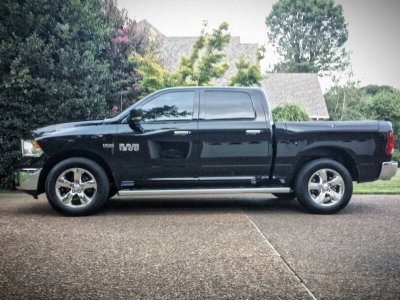

Hey guys got me a 14 Ram Big Horn Edition back in June...love the black color especially when it is clean...whew...hard to start that way...today I tried a few products you guys had mentioned...seemed to do pretty well...Washed with a microfiber hand mitt...hand washed the suds from a spray down at the local wash...Meguiers Chrome Wheel Cleaner...spotless rinse...wipe down with microfiber towel...then applied turtle wax black detailer...Meguirers Tire Gel...thought it turned out pretty good...I want to play with several products...lol thanks for all of you guys insight... uploadfromtaptalk1407030958208.jpguploadfromtaptalk1407030977900.jpg
