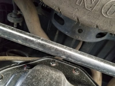

Just crawl under the truck and there should be a tag of some kind by the rear axle?

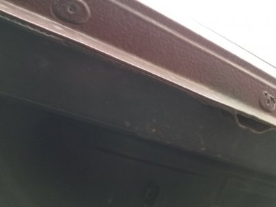

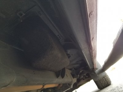

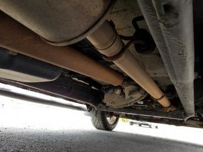

All I Could find. Mind you everything is linex or por15. Including all other shots if anyone was curious what I did to protect the under belly.

In the last shot, my underside does not look like the ones I see in the air suspension installation videos, never seen that yellow thing ... yes I am mechanically stupid, lets talks computers, coding and networking hehehe.
