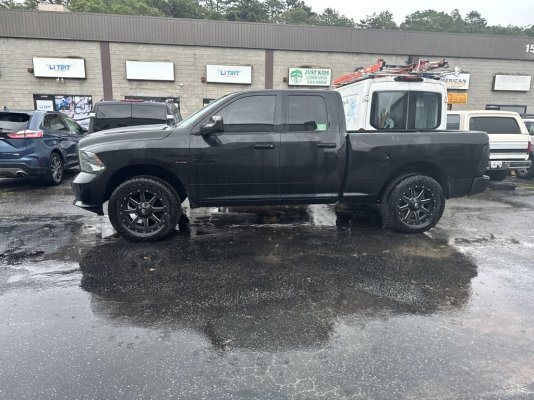

So I searched the forum for a thread like this and didn't find anything. I figured it would be fun to have a thread that everyone can watch what everyone is doing each week.
This week I put on Steelcraft nerf bars, and right now I'm getting the permaplating put on the truck. This way it gets a real good bath.
I went to Quick_Shifters shop, I had a shimmy after laying off the gas or hitting any dips in the road.
He checked all the torques for the rear control arms & rebalanced all the wheels in his meticulous way of diagnosing problems.
It ended up being a broken bushing in the pass. side lca-Core, replaced with a set of Freedom off-road.
He will replace bushings on my Core arms & switch back next time I go to his shop.

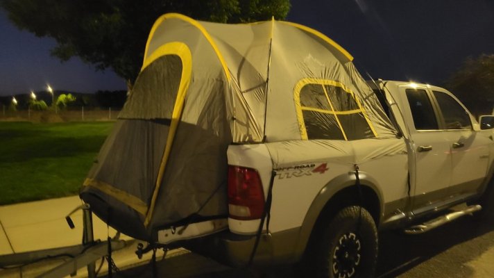

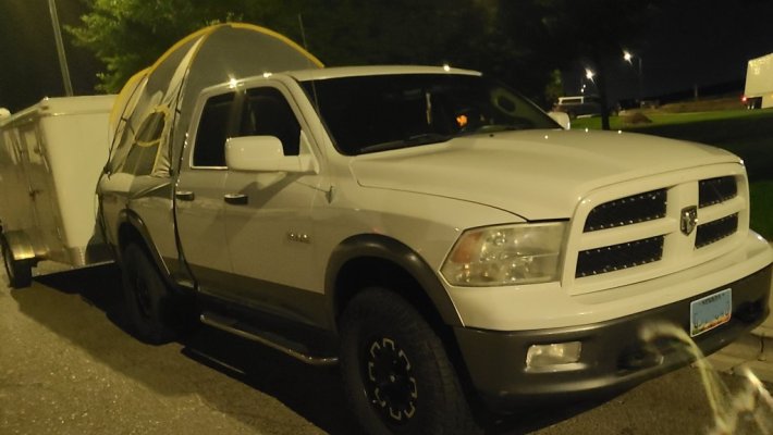

I like that bed tent, gonna have to take a look at those.
Recommend getting one with a fly. Haven't used it in Dewy or rainy conditions yet, but think I probably shouldda got one with a rain fly.

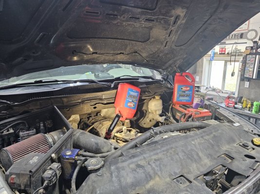

4th oil change with valvoline restore and protect. Greased upper/lower ball joints, tie rod ends, and front/rear sway bar links with Lucas red and tacky. Emptied the catch can. Good for another 4500 miles now.

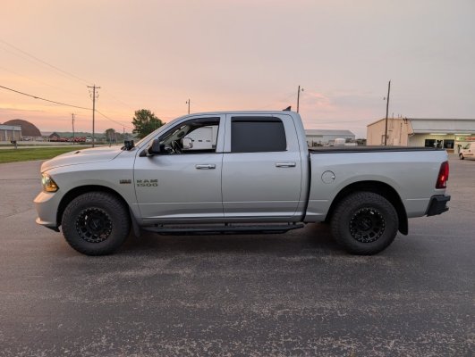

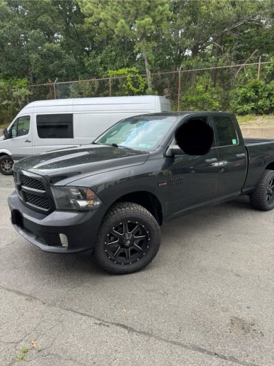

Not exactly this week's project, but my summer project this year was taking the lift off my Ram.
35s, Bilsteins set at 2.8", Zone UCA, Icon rear springs, rear Fox shocks, and extended sway bar links f/r all came off.
285/75r17 Falken Wildpeak at4ws, Eibach Pro Struts set at 0.7", Moog UCA, stock rear springs, Bilstein 5100 rear, and Moog f/r sway bar links went back on. Had to recenter the rear track bar, but it was all fairly easy to get done.
Tows better and the ride is super nice now. I'm happy with the look, it stayed pretty similar to before with the 35s.
Going to be listing the rear "lift package" here soon.
