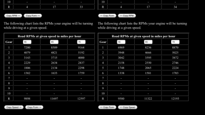

this chart shows rpm vs mph.
Left is stock tires with 4:10
Right is 4:88 with 295/70/18
I have read no Speedo calibration is required

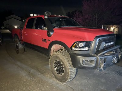

I don’t. My truck is purpose built, and towing isn’t its purpose.
433F1791-B7A0-4C23-96C2-96505DF33069.jpeg E2914C4D-9DE0-4145-B444-04CF62852DE6.jpeg C093D3B0-656D-4205-A1B6-DFAA326587CF.jpeg
Edit: not to say that I haven’t, and that I’m not experienced in towing. It’s just not what my truck does on the regular

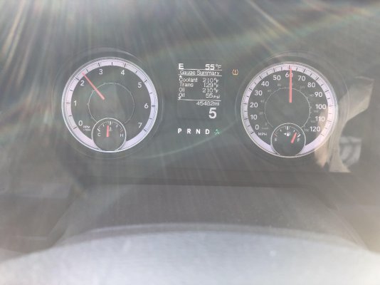

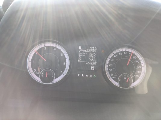

COAinPaso
Nov 6, 2017
66
54
6.7
Make the appointment! I went with 4.56 and sometimes wish I went lower. Cooper 35’s that measure 33.5 installed makes these rpms-
