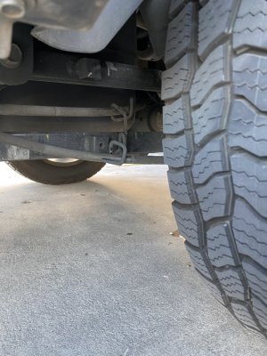

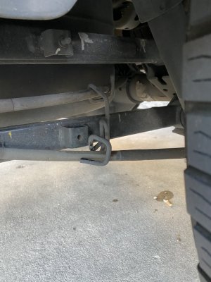

What is this part and where does it belong??
PE7EY
Aug 23, 2019
26
USA
So I heard a rattling noise towards the rear of my truck everytime I hit a bump. I thought it was a loose spare tire chain but I found this hanging from the emergency brake line and driver-side rear trailing arm. Can someone share a pic of where it belongs? I can't seem to find info on it. Thanks!
White six four
Dec 31, 2019
796
1,559
Wisconsin
Looks like your bolt holding the bracket on is missing. Find the bolt or buy a new one, I'm not sure on the size, slide it forward and turn it 90 degrees to line it up and bolt it back up.

White six four and David H, thanks guys! I really appreciate it. Hopefully someone else here can share the bolt size or even send a part number.
I just remembered that the rear trailing arms were replaced under warranty last year and I suspect that bracket wasn't tightened well enough.
