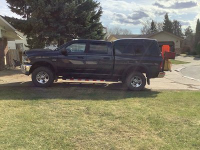

pulsar/magna d-fit muffler resonator delete I used the pulsar for recalibration no tranny problems that I can notice when I got my truck mileage was not a concern I knew it would guzzle gas since I have put my truck on a diet it has gained about 800 lbs with the capper rock sliders ,tire carrier he's a heavy old redneck mobile now
