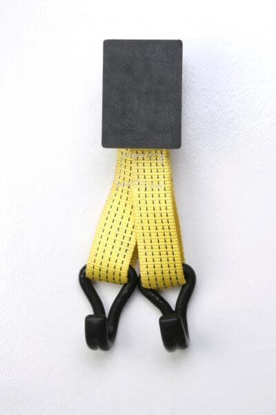

A comealong is OK in a pinch but you will be doing a lot of moving, blocking, moving, blocking, repeat until unstuck. If you're going to be doing a lot of offroading, get a HiLift. They have an accessory hook that hooks into your wheel, lifting it up off the ground instead of trying to lift up the entire truck. I have one and it's damn spanky handy. Hooks over the tongue of the jack, into the slots in your wheel, off the ground she comes!
https://hi-lift.com/accessories/lift-mate/
