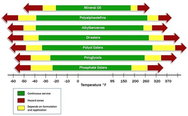

If the temps stay high, you might want to change that over to redline c+, ester based fluids buy you a lot of degrees in the bank. OEm fluids are fine for things that operate in regular temps, but anything that doesn't operate in general operating temps are going to benefit from high quality base fluids. This is how those oils help hemi tick, that area is very hot, metal out of tolerance is always gonna create pressure points that are high temp, and we now those esters are sticking on those locations better then group 3 oil. I only bring this up when it matters. PAo also gives good hot temp protection, redline= ester + pao. When did you notice for the first time these temps?
