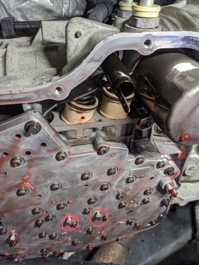

So new VB and New SP? Check sump filter, did you pull out o ring? It usually doesnt come out with filter.
I haven’t been able to get the old o-ring out, it’s majorly stuck in there. It’s from around 2 fluid changes ago.

Did you carry the plugs over from the old VB to the new one?
Sent from Blue Onyx
Can you see it, are you 100% it isn't two o rings jammed up there? If it is truly just one and it's in good shape, don't worry just keep using it.
It’s just one and it provides a lot of suction whenever i put a filter on, almost hard to put in. There’s only 1.

Most likely explains my issues, what i’m thinking is that the new VB in my truck has different tolerances than the old one, and that the solenoid pack is either worn/damaged inside to where it doesn’t know what the **** to do, and is just acting erratically. I should’ve bought a SP.

I forgot to mention this, I disconnected the battery for around 2 hours and started the truck back up. It didn’t jerk going through the gears, and it shifted fine into 2nd with barely any jerking and then after a few minutes it started to harsh shift again. Is this more conclusive evidence of a bad SP?
Also, there’s a card in bike rim sound when putting it into gear, i don’t know if that has to do with anything. Did it previously too.
