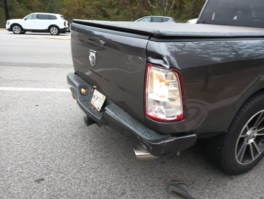

What yall think is it totaled

Insurance will compare its “salvage” versus their “pay-out”.
If the truck is worth $20K…. and there’s $10K of damage….and the salvage/parts are worth more than $10K …(and it appears they are)…..they’ll Total it…because with your deductible they will come out ahead.

The bed hit the cab its over 100% totalled nost saying its not fixable but id bet the frame is tweaked in the rear.

The hit on the left rear reminds me of a Dodge Dakota I had. Many years ago had a regular cab Dakota. Let my son drive it regularly. One night he and a buddy driving around and out on a dirt road trying to "fishtail" on purpose, lost control, took out a mailbox and right front impacted a culvert when they ended up in the adjacent ditch. Luckily no one hurt. Anyway, truck did not look bad, not as bad as what yours is showing, just showed damage to right front instead of left rear. Long story short, truck was repaired by highly recommended body shop and looked good. Ultimately though, they found the frame rails were fine and straight, however, the frame was "diamonded." They ended up having to disassemble the truck and reassemble on a new frame. So even if your frame checks out straight and looks good, a good shop should be able to determine if you have a similar diamond issue (truck will go down road "sideways") if they put it on a frame straightening rack. Good luck!

The trick is never have the a$$ get tagged in the first place. Nobody mentioned miles yet??
