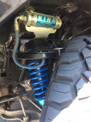

I did a level with 18”x9” 35x12.5 & did have slight rub on my uca’s, they are Carlis a little thicker than stock, ended up adding 1” spacers to fix. I would think the 11.5 would be fine, forgot to say my rims are+ 1 offset are pretty close to flush with flaresC2D7A936-8458-4AB7-9131-F45AF492045B.jpeg

Thanks! That fit looks perfect. I’ll be running the Icon ucas, dont know how that will look compared to yours.

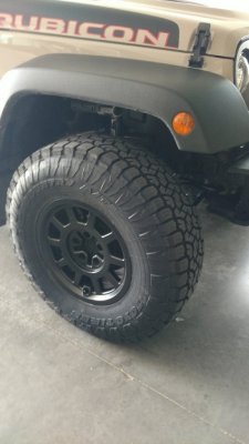

curious on what 35x11.5-17 tire you are going to run. I ran 35x11.5-17 Toyo AT3 on my jeep with AEV 17x8.5 wheels and were good I think 9.5" wheel might be a tad wide as less side protection on the wheel. I like that size tire but did not see any in E rated.
