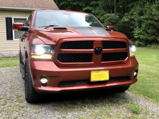

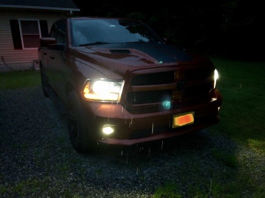

I installed in 17 laramie came with 6 bulbs high , low, fog, and they are very bright.they have a whip on them that attatched to factory plug and led and fan body fit behind the dust cap as well, csnt speak for others but that's my truck with them installed6464cfd78e7a32d659ce76958996f46a.jpgcab837fd79122dbe54ea9db8dbf81985.jpg
