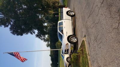

Maxtrac 2.5" 2 piece spacer system.
Factory UCA's
No issues
3" PA Body Lift

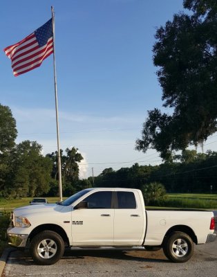

Bils at 2.8 for about a month now. Zero issues

I have a 2014 with bilsteins maxed out at 2.75". Also have 1.5" poly spacers on the rear springs. No issues at all. Rides smooth no vibes. Stock control arms btw.

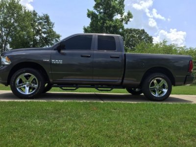

I have a 2WD. I got the Mevotech UCAs and TopGunz 2.5" level spacers. Been on there for a few months now and no issues at all.
