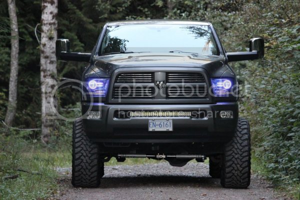

Mine stick out about 4". Here's a couple pictures for you.

For the record, I threw my 2" wheel spacers on with my 22x12 -40 offset Forces and 37x13.5's just for ***** and giggles. I have 9" of lift on a 3500 so equivalent to about 12" of lift on a 1500 and this was the result.
Did it look sick, yep it did. Was I able to turn at all. Not a chance... Hit both the fender and the bumper FAR before full lock.
So like I said, more lift is needed for one (more than you'll get on a 1500 without going to a custom built lift), and then either steering stops to the point where daily driving your truck isn't a feasible option anymore, or cutting the **** out of your bumper and fender (which some guys do).

The traction bars on the back are an optional accessory to add to the lift if wanted. They aren't required. Long arms refer to the front lift setup only.
I highly doubt you're any higher than me. But that can be confirmed by measuring your fender heights front and rear. That way we know for sure.
What I have learned in the past little while (and I should have clued into it long ago) is that the track on a 2500/3500 is wider than a 1500. So 12" wides on my truck stick out further than they do on yours. That's also partially because my front diff is off to one side by 0.5". So that changes the calculations that I had done before comparing what you could get away with compared to what I could.
one more thing how much would I gain if I went from 20x12x-44 to 20x14x-76
Stance wise, you'll gain about 1.25" per side.
