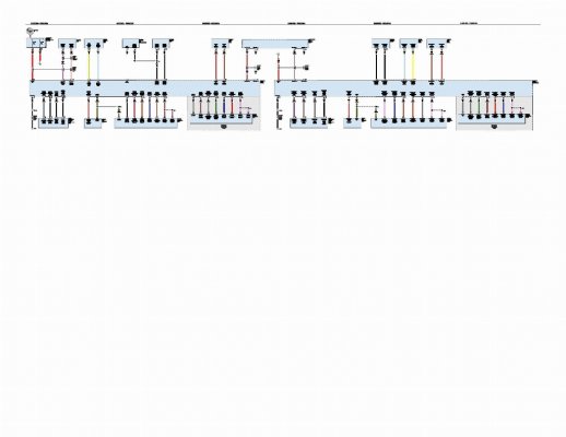

Hello,
I want to try to make the mirrors auto folding when I switch the RAM on and off.
The switch in the door is just a puls switch so it sends just one signal for opening and closing.
I have found a schematic for the module in the door that controls the mirror motor but not for the switch.
Can someone help with a scheamtic for the switch or wich color is the wire that goes from the switch to the module?
Thanks and greetings,
Erik.

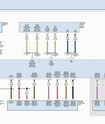

It’s not possible via wiring. It’s a message that the BCM sends to the door modules via Lin Bus when the switch is pressed. The auto fold is not an option on any Ram. It is an option on the 2018 grand Cherokees, and I’ve tried using 2018 grand Cherokee door modules along with the AlfaOBD settings, but it still doesn’t work. So, it’s gotta be the BCM itself that isn’t capable of it. This is your best option- https://www.zautomotive.com/product/tazer-ram/

I want to try if it is possible trough the switch (that gives a signal on the LIN bus as you said), it is either a TTL signal (5v) or 12V or just a NC contact that is why I searching for a schematic wiring from the switch.

I think it can works with this IC :
On the out can be connected to a relay that can be used for ground to switch, +12v to switch 5VTTL to switch...
To jimmy07 : I have that schematic too but there is no mention of the folding switch?
Those two lin bus wires handle all of the buttons- left/ right mirror select, mirror up down left right, etc
