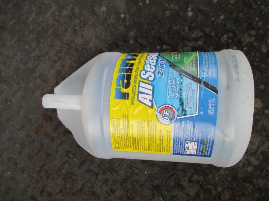

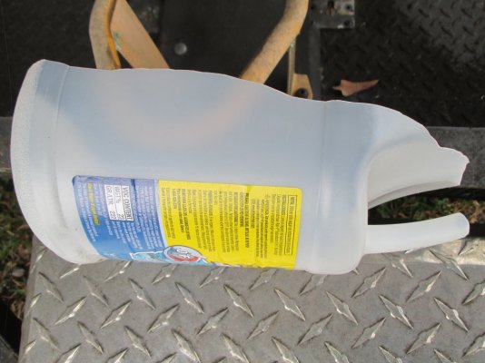

No argument it is a very poor design. If you take and cut a washer fluid jug properly you can retain the handle to position it and put it under the filter to catch the oil and the filter. Keeps the oil from getting all over the axle.
This is a commercial version called Pig Form a Funnel. The washer jug is free, just cut length wise, contains all the oil

I cut a Rain X windshield washer fluid bottle in half to catch the oil from the oil filter from my 5.7L Hemi. I loosen the oil filter with my oil filter wrench, slide the half bottle under the oil filter, tip it down, loosen the oil filter until oil runs out, then leave it alone for a while to stop draining, then remove the old oil filter with the half bottle.

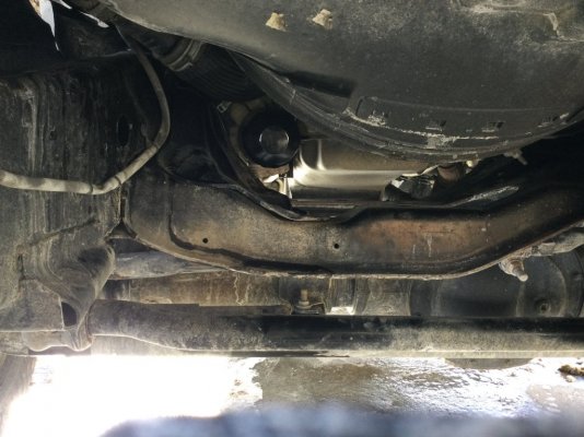

BBFE8EDC-C871-42B2-8E84-808E33E75BD6.jpegIt’s not that bad. Put the large ziplock baggie around underneath it and twist slowly, some oil will dribble into the baggie. Unscrew it the rest of the way but don’t take it off. When you remove it from the threads have the baggie ready as a big glub of oil will come out. If you drop the filter or the baggie you will have a mess. The oil will run over the side of the tray. The tray works well with drips, not the large dollop. Have brake cleaner at the ready.
