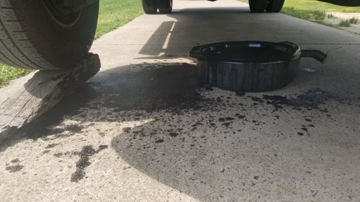

worst setup to change oil i have ever seen

I just wrap the axle with a trash bag. I use a plastic garbage can lid with several holes drilled near the center upside down on my drain funnel. Lots of coverage for auto transmission pans too. Drained a 2019 limited and it didn’t hit anything.

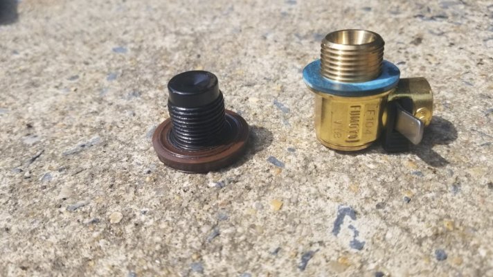

That takes care of the oil hitting the sway bar issue, but not the oil filter mess. Of the two, the oil filter can make much more of a mess. I just installed a Fumoto valve in place of the drain plug. It has a small extension that I connect a hose to and the oil all drains into the drain pan with zero mess from that. I've been using the double zip loc bag trick for the oil filter, and that keeps most of the mess away. But I haven't been able to totally eliminate the issue with the filter.

Cummins guys can relate a little. The drain plug drains like a garden hose and then add wind & you're living a nightmare. This was my first oil change and Fumoto replaced it.
(Warning, photo below may be disturbing)
