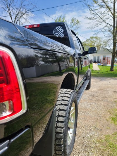

Installed an Edge 3400 converter Saturday. I did a little video. This was no brake applied. Just punch it. I’m on my 35x12.5 Nitto Recon’s, not my street tires.
This was from a dig, 3.21/TruTrac, 35x12.5R20 Nitto Recon Grapplers. It would’ve spun forever if I hadn’t let off. Did not use the brakes.
