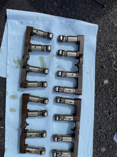

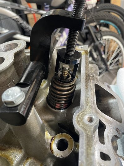

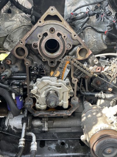

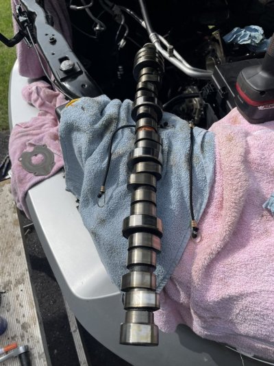

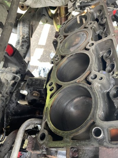

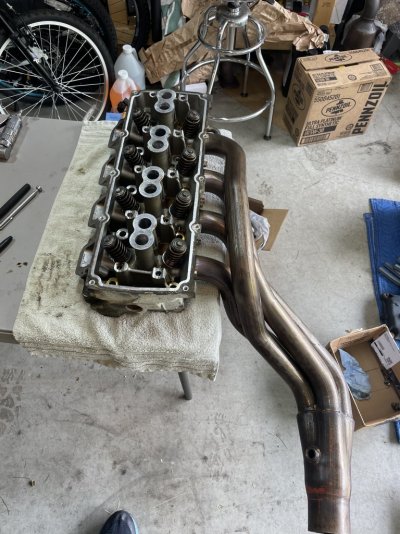

Its daunting. I marked the timing in 11 places lol. If I hadnt, this would be a different storytime! When I I was reinstalling the phaser, the chain evidently slipped, but looked good on the marks until I released the tensioner it looked slightly off, but close like I marked it while standing. Segway to after heads were on and I was torquing the rockers.The guide washers have keeper tabs, one was pinched, and it snapped the guide in half. Ran to CDJR dealer, had to buy a new arm…$196 to get that little piece off it. After assembling rockers and pushrods, rolled the motor over, interference. No doubt. Had to disassemble and retime it, I was a tooth off. After that it rolled over perfect. Fought the exhaust because my TSP headers are slip fit. Uggghhh. 2 1/2 days of work.
I am beat-up, tired, scraped up lol. But I have a smile haha.
