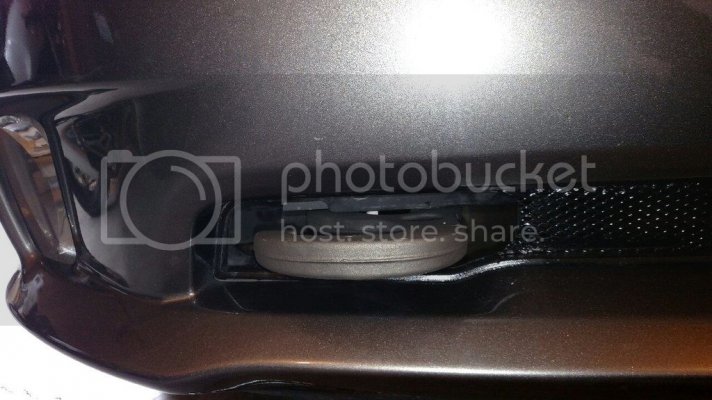

Prototype Bracket Fresh Off The Machine & Test Fit
Heres the Prototype:
And the test fitment:
Centered in the Opening:
Hooks pointed outboard:
Bottom of the hooks have plenty of clearance, theres no interference with the bumper:
The bracket to bumper interface uses oval holes, with allow about 3/8 inch of left/right play in the fitment. This should accommodate any variation in the bumper bolt pattern from truck to truck, and also give the user a little room at adjust fitment for his individual bumper.
The bracket to hook interface uses slots rather than holes. This retains the front impact breakaway function in the original design.
When pulling, at approximately 500lbs of force, the bracket flexes sufficiently that the rearmost bolt, with the rubber shock absorber, takes the rest of the pulling load. However in the event of a front end collision, having rigid frame attached tow hooks would defeat the purpose of a crumple zone bumper. In a front end collision, @ several gs of force the hooks attachment bolts would be push free of the brackets slots. The hooks rear strap style connection would also be allowed to push free in the event of a front end collision.
