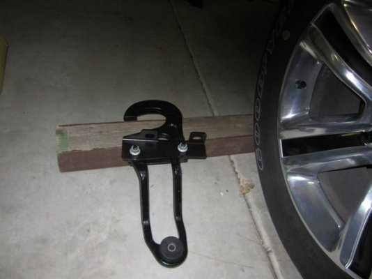

:) It's a rubber spool/w fat washers on the down side 2" x 1-1/4/w 1/2" sleeve thru the rubber doughnut--
It's kind of a one use fitting, maybe available at a dealer --parts department-
Whatever
:crazy: JIMBO

Ugh. I tried to save money and bought used tow hooks. They showed up today and they're missing the rubber bushings from the back, which aren't sold separately. Wonderful.
Damnit ! Well ?

From the way it looks, I think you would have to actively remove them from the hooks.
If I had the dimensions I might be able to find one online that would work.
I bought them from a yard so I think I'm going to give them a hard time about it.
You are correct Sir , one would have to remove them on purpose. .....give them.a hard time !

I'm going to take some measurements tomorrow and see if I can find something close. I'm not really sure why it's there, but there has to be a reason they wanted an isolator there. Otherwise I'd just stack washers.

:) I gave you measurements and the rubber spool isn't pressed into a hole--
It snaps into a slot at the end of the tow hook-
did you call the dealer parts dept ??

Yeah, the part is not available separately for some reason. I'm going to try to find one in the dimensions you listed, but I figured I'll take some measurements to get a range of what might work well enough if I come up empty.
Remember I said the rubber part of that bushing is a "SPOOL" that SNAPS into the end of the tow hook and the SPOOL center dimension is 1-1/2"-
Since the FRAME mounting of the hooks absorbs the majority of the FORCE, when applied---I'd just use a 1/2" spacer--metal/rubber/plastic--because you'll probably never find a bushing LIKE THAT any where-
Good luck

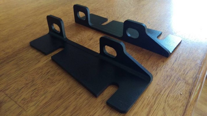

Thanx again Kenneth for the tow hook brackets--they just arrived and look so professional, they autta install themselves :roflsquared:
I'll probably have time to set em up by Sunday/w pics-
Thanx again Ken !

Very well made, figured I'd post a picture of them unboxed. You can tell Ken takes pride in his work.afc2e5e0c3095b00cbd6a07228e122ef.jpg

:) Yes sir, thanx to Ken226--MY HOOKS IS IN !
Thanx again Ken !
:crazy: JIMBO
Very nice indeed Sir !
Good idea on the holes on the ends through the plastic

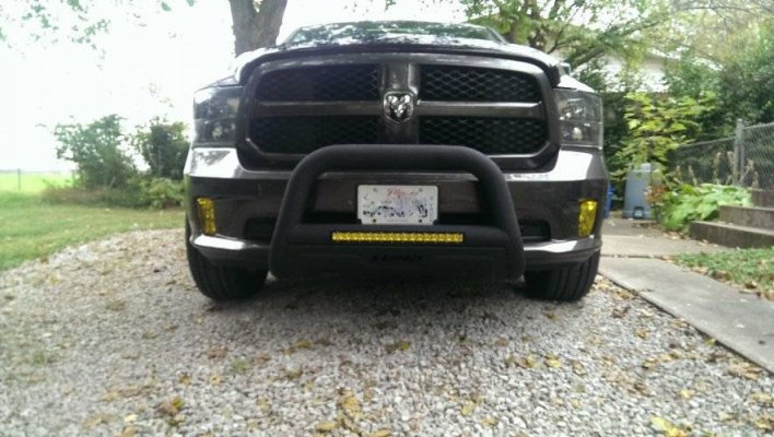

I was thinking about figuring out that when I redo mine and posting that here. I already had my hooks installed, but this bracket will place them in a much better location and allow easier access around my Lund bull bar...e5991f0db68b8e3fae7a29d2f6b93cf3.jpg
