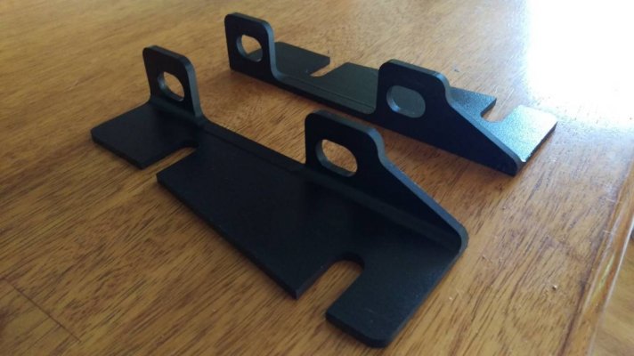

Went back and read through some of those posts for additional details and that definitely looks like a well made bracket to properly locate the hooks in the sport/Express bumper.

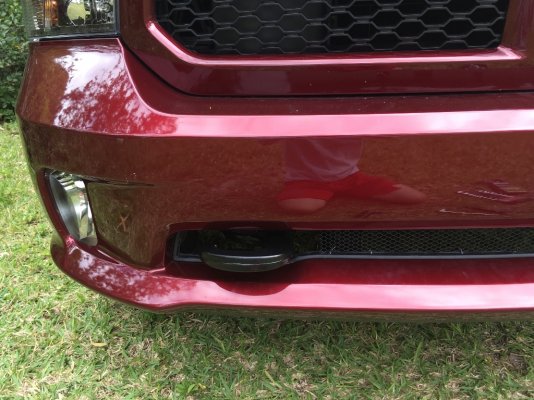

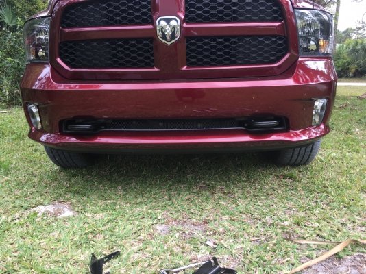

I should have taken a side by side of these brackets. Man they are noticeably beefier feeling. And they fit beautifully. Hooks showed up early. :D install was a piece of cake. Install the bracket as far to the outside as it'll go and snug it in some. Installed the hooks. Then tightened everything up to goodentight.

Lucky for me it was factory. I did the mesh in the lower bumper insert though

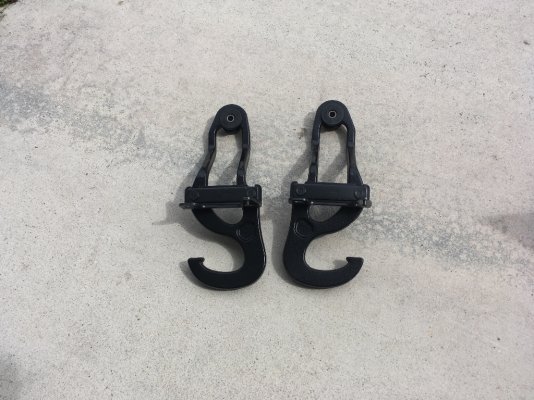

I got my brackets in this week. They are really nice quality. Waiting for my buddy to powder coat my second hand hooks, the I will cut the bumper insert and get the bad boys installed.

I received my brackets today and installed them already. Super easy to do and came out just how I wanted them! Excellent quality, thanks Ken!

Trying to break down my hooks to powder coato them. Can't get the bracket bolts free. Tried PB Blaster. Soaked over night, and the breaker bar nor the impact gun will touch them.
The bolts look pretty rusty, but the exhaust bolts looked worse. Could there be loctite on them?
