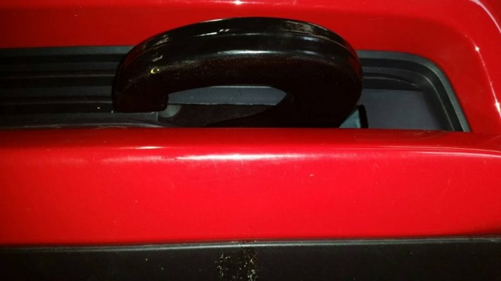

Is there a right and a wrong way to face the hook ends?
SitKneelBend
Moderator
Member Relations Specialist
Jan 8, 2015
10,998
7,704
St. Louis
3.6 Pentastar
Technically yes, the openings should be faced outboard...

Would you not want the ends facing inward?

Not according to the directions. Some with the sport bumper do so for a little more clearance. There's nothing stopping someone from installing either way.

The factory puts them outward ; however, they are functional either way .
I put mine inward because the fitment on my front bumper was better and not contacting the bumper .88996ae80505d2a90d6cf13bf2049931.jpg7949468767a0fd9d494519f8bf4a083b.jpg99203f3688afd5765848f0f062ac1cbc.jpg

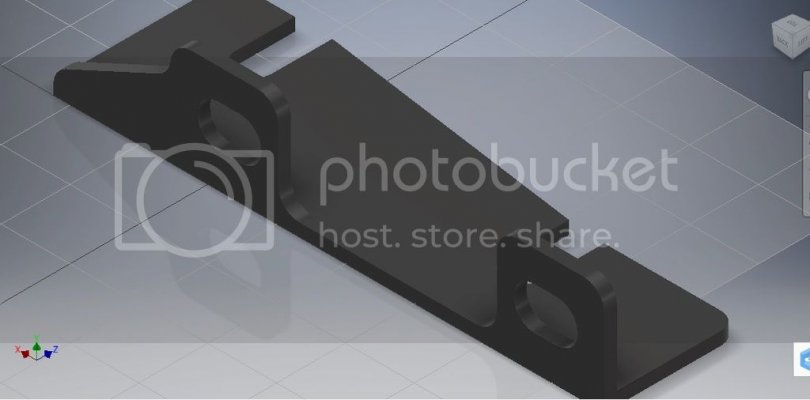

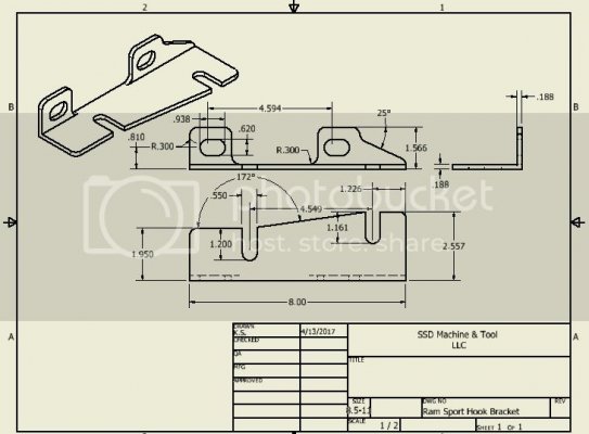

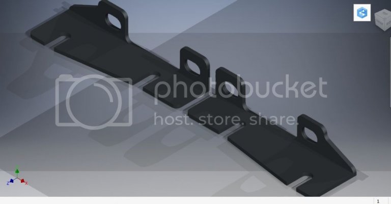

I had a few hours to spare and did the CAD work today. These dimensions are based on my own trucks measurements, so as long as yours are all the same within .01" or better, all should go well. Feel free to point out any errors I've made.
I'll start the CAM work and generate some g-code in the next couple days.

Very nice! I have them installed with the hooks facing in for clearance like RLK. This might make me want to pull them off and switch them over. I would be in for a set as well if you decide to sell a few. At 30.00 it's a great deal.
