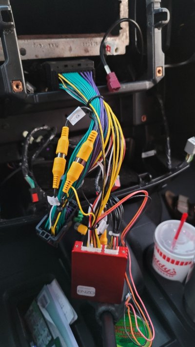

I recently installed the Customtronix Enzo into my truck that I have an 18' UAQ 8.4 Ram radio retrofitted in to. I have installed the keypad and rebooted the radio 4+ times after enabling dip switches 1,2,7, & 8. The radio reboot works when holding the #1 button on the keypad but when pressing any of the keypad buttons to display cameras the front camera screen does not display and the factory installed reverse camera does not work when pressing button 4. I do not yet have a front camera installed. However I have the factory installed backup camera and cargo camera. Do anyone have any idea what I may be experiencing or how to resolve the issue? Also, since my truck came with the cargo camera from the factory does the cargo camera dip switch need to be set to the on position or should I leave it off? I'm also wondering if the park pro will work and if the front camera will automatically come on when shifted into gear because my truck has a factory manual transmission instead of the more common automatic. I've sent Magnus an email and sent a detailed question on their contact section on their website. There is a before & after picture of the harness from me cleaning it up by wrapping it on Tesa tape to help make it look more factory. I would appreciate any input. Also used HD velcro to mount the dip switch box under the radio along with the video & aux inputs to avoid having to remove the radio for future cameras added or multimedia. b8fa1960065c615f9104fe6637389332.jpg270aaa421b21cde9b27dd000cb0ff686.jpg24322bb2063e7796676a1f030718a79a.jpg

Unfortunately, you do need access to both CAN lines. The reverse switch signal comes in over CAN-C but the messages to display the backup camera are spit out over CAN-IHS.
I swapped the larger display into my truck a few months ago and am experiencing the same issue. No reverse cam when swapping to reverse with my truck. (g56). I read through the posts and it sounds like you've made great progress here. Any updates on how it is going?

Update: After sending Magnus @ Customtronix an email I was able to get some information on the issues I'm experiencing. He stated that it will not work because the canbus message is different for auto vs manual. I was informed that they don´t trigger on manual. He also stated that the keypad (used for manually & quickly viewing video inputs) will not work with a manual transmission as the back button triggers differently than the keypad. It's unfortunate that the keypad doesn't work as I could live with the front camera not automatically engaging when the corresponding dip switch for park pro is set to the on position. Due to my truck being a G56 and having the factory installed cargo & reverse cameras I have to cycle through the media inputs with either the back button or mute button on the radio bezel. The navigation address in motion lockout disabled feature still works correctly which is also nice. So until I find a way to easily view my front camera with me not being able to use my cargo camera input on the radio I will have to deal with utilizing the back and or mute buttons on the radio to view my front camera.
