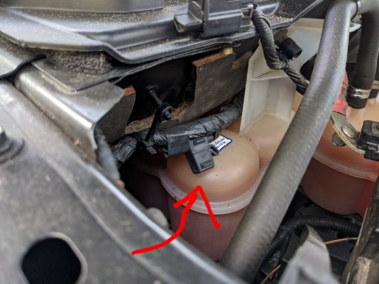

Thanks for the quick reply. Can you be more specific on where this fuse is. I’m looking at the break booster under the hood and there is a rectangle box with 7 fuses in it that are either PTC Heater or Glow Plug Mod
Should be on the harness coming out of the firewall by the booster. It's a single black fuse holder.

To pile on, open the hood and look for a wire coming out of the firewall that has the aforementioned fuse holder, the fuse will be roughly between the break booster and the battery.abcced598dd6d4586e4974d880a5253e.jpg
It worked! Thanks! I would have never found that fuse. Thanks again for the quick replies and help!

FYI, on dual battery trucks (ie Cummins) it's on the passenger side... someone finally sent me a picture of it...

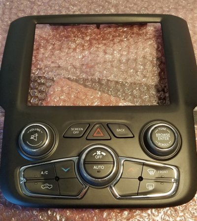

Someone else....
But here's Info 's solution for a Single Zone ATC bezel (included with all standard kits apparently. Vinyl wrap the extra passenger buttons?)
And ours ...

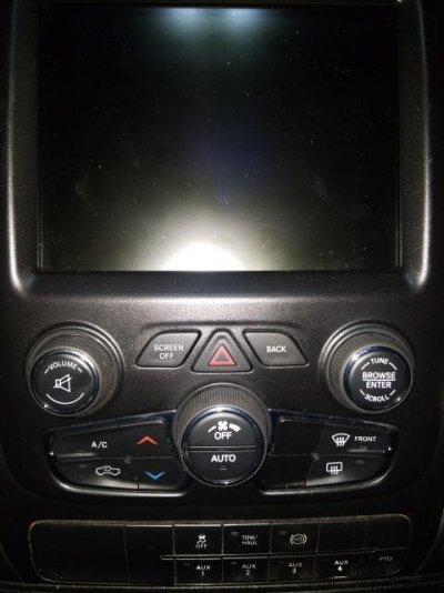

Just for clarity, would I be doing any harm with a UAS installed but not having done the Single Zone ATC mod? I was under the impression all that was wrong is I needed to press the hot and cold buttons many fore times than is indicated visually and that was the only hiccup...
Message me your number and I'll give you a call/text later after I'm done running around with the wife.

I have the same concern, mine seemed to work correctly upon installation but now that the radio has learned my truck I'm not so sure. I need to drop my glove box to confirm.
Sent from my SM-G970U using Tapatalk
And check your a/c clutch to make sure it turns off when the ac button is turned off while running

OK, finally got time to check my compressor. It only comes on when either AC or front defrost is selected which sould be correct. When I installed the radio the first thing I did while I had the glove box and upper storage tray out was look at the blend door and the display on the screen to see if the positions matched and they did apear to match up correctly. Now after the radio has learned my truck I'm not sure they still match. I need to pop the upper tray back out to verifiy this. Unless I was lied to by the salvage yard my radio came with the single zone bezel from the same truck which means it was a factory single zone manual setup. If indeed mine now has the bug it must be something it learned from my BCM?

I only have the standard MTC 8.4 bezel for my truck that I've been running your single zone atc harness on for quite awhile now. What would the single zone ATC control panel cost? I have looked online and can only find MTC or dual.
